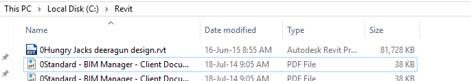

@Yna_Db : Thanks for reply but to simply explain it : I want to open current project or family location in Windows explore where the file (RVT,RFA or linked CAD file) is saved.
Do you mean like a “Save as” dialog?
No; just to open where it’s located, like this:
