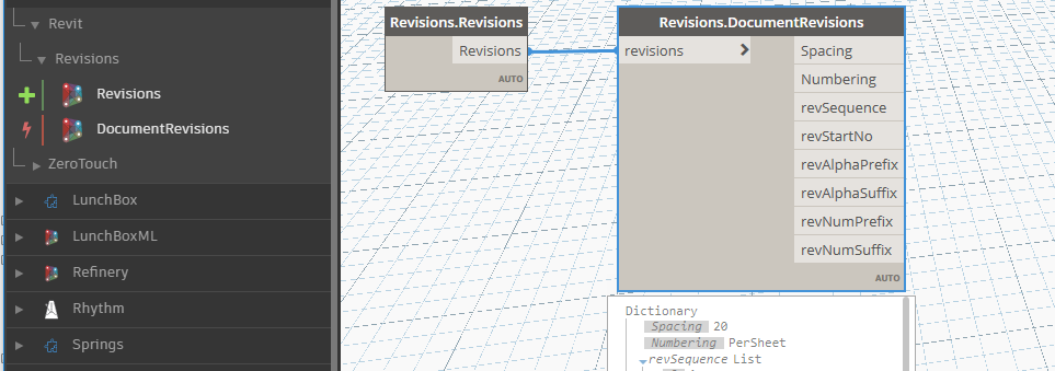

I’m trying to create a zero touch node that outputs multiple revision settings. However, I’m getting two separate nodes one with revision settings and other with all the properties
I’m not sure why they are separate?
Here’s my code:
