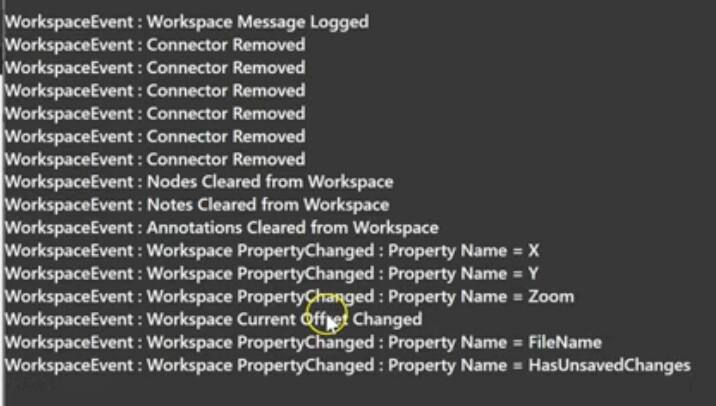

I want to capture the event in a viewExtension.
This is where I got that information.
Capturing NodesCleared you will end without any nodes, because the action fires after all the nodes are removed, so the best solution seems to capture MessageLogged that is the first event called when a workspace is closed.
        public void Loaded(ViewLoadedParams viewLoadedParams)
            _viewLoadedParams = viewLoadedParams;
            viewLoadedParams.CurrentWorkspaceModel.NodesCleared += CurrentWorkspaceModel_NodesCleared;
        private void CurrentWorkspaceModel_NodesCleared()
            var dynamoViewModel = _viewLoadedParams.DynamoWindow.DataContext as DynamoViewModel;
            var nodes = dynamoViewModel.CurrentSpace.Nodes.ToList();
            if (nodes.Count == 0) return;
