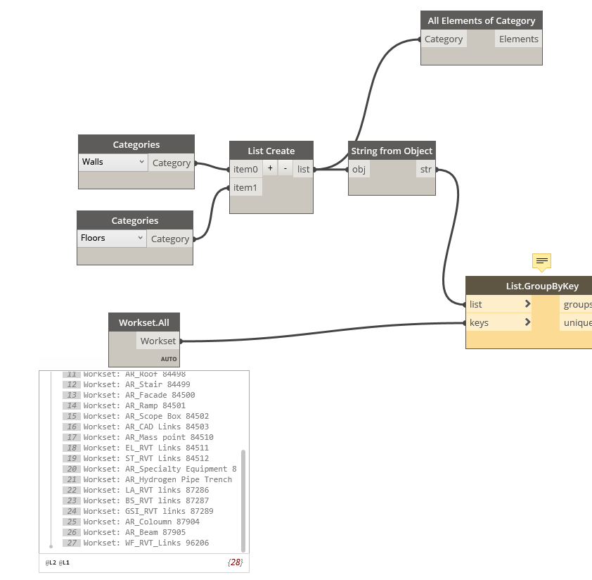

My guess this is what you are looking for.
Now you have a list with elements grouped by their Category.
You can set the Workset for each Group now (didn’t include that part in my screenshot).
Make sure your Workset order matches the order of the Groups.
Pay attention to the levels and lacing.
Like this then? I showed 2 examples (elements grouped per workset).
If this is not what you are after maybe explain what you wanna achieve.

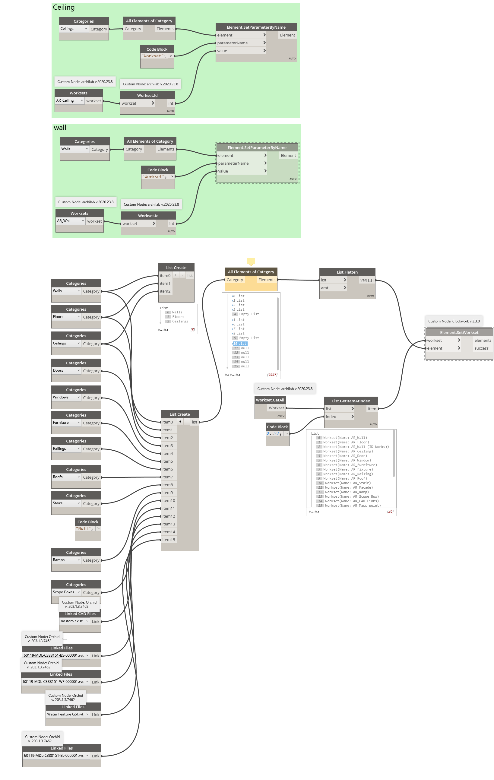

okay I will try to Explain, if a wall in any another workset like workset 1 , I need that wall in AR_Wall workset. may be below image is example. just I need correct categories in correct worksets.
I wouldn’t bother asking ‘are you on the right workset?’
Instead just set the Workset en-mass.
Create a list of the categories you want to change.
All Elements Of Category node to get all the elements by the matching category.
Create a matching list of the worksets you want to set the categories to.
Element Set Workset with proper list levels and lacing. I believe @L1 for Workset and @L2 for Element and longest lacing should do the trick.
