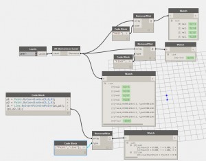

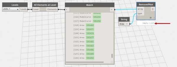

I am just trying to select all areas from a specific level.

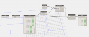

Bill, is it due to the fact what you are passing into the node is a list of elements and what you are trying to remove is a string. You could use a FilterByBoolMask like below instead.
Ritesh-Attachment seems to not be working anymore right now. I found out how to blow it up though.
Mark, that method worked! Thanks! I would still be curious why the remove if not didn’t work just for my own knowledge
This looks like a bug. It should work for elements as well.
