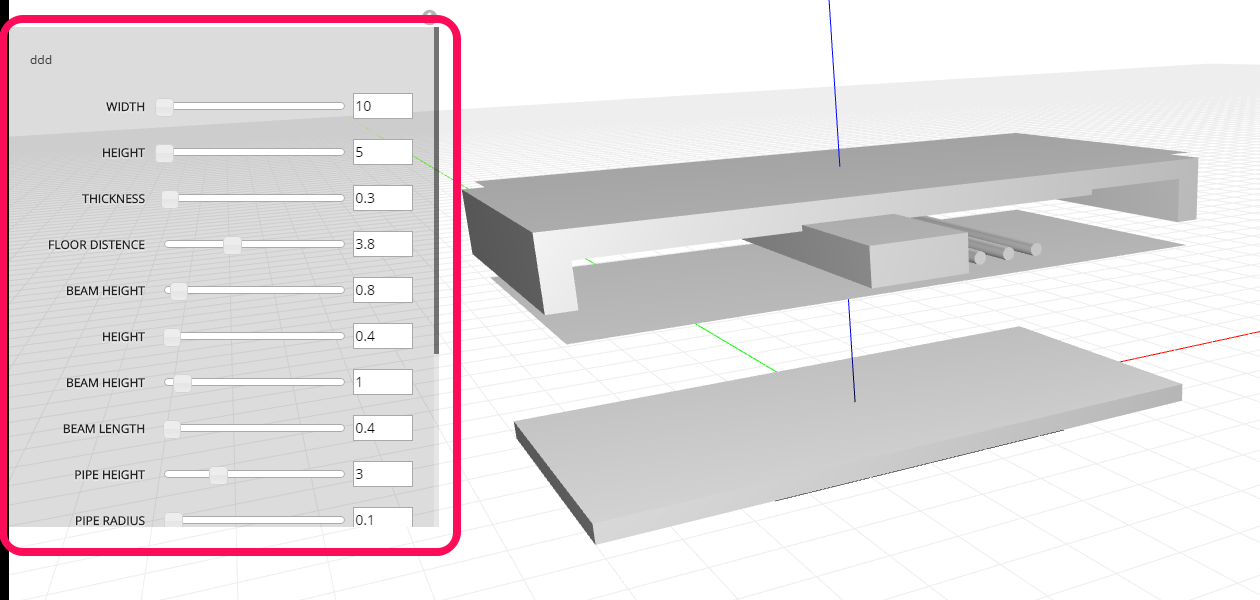

I use “send to Web” to publish my project to Fractal, I only got input parameters panel, but there are no input sliders out there, Why?
what’s the problem?
And what should I do to make the input slider out like below?

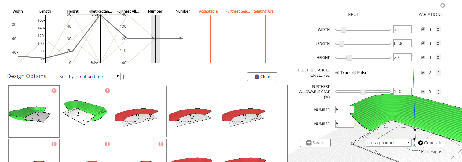

but I mean, I can’t get the cross slider like below, and there is no “Generate” button under the INPUT sliders,
Why?
