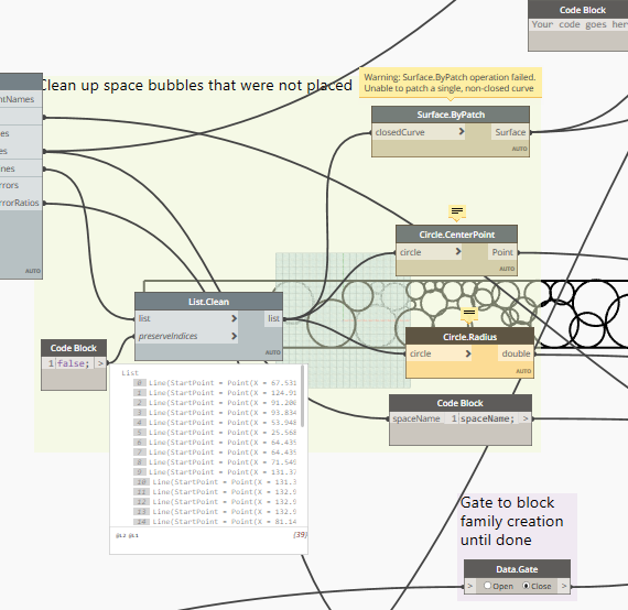

Warning: Surface.ByPatch operation failed. Unable to patch a single, non-closed curve
Hi! I hope someone can help me. Im trying to do a Bubble diagram for a school project. I downloaded the package from Refinery toolkits. Im new to Dynamo.
When I get to the Surface by Patch it gives me an error
I would appreciate any help! thank you
Screen Shot 2021-10-22 at 9.32.37 AM
Surface.ByPatch requires a single closed curve to patch. You’ll have to group your curves and combine them into polycurves first.
