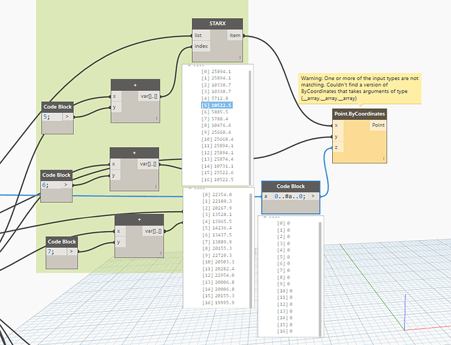

Warning: One or more of the input types are not matching

I do not understand what the error was. Can you help me fix it

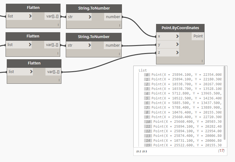

Your x and y values are strings, you need to convert them to numbers
