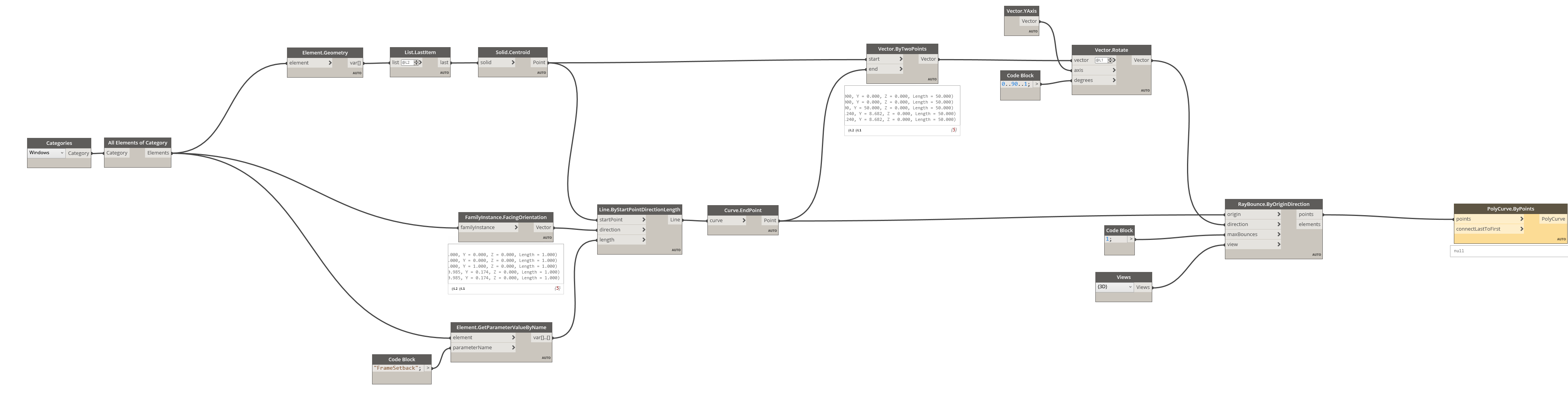

Im trying to calculate the angel from a windows to top of an obstacles in my example a wall.
My problem is that my rays are comming out in a funky way. Left side the rays are going in the right direction, but the right side they are going in the wrong direction.
I guess its something with the vector.rotate node but cant figure out what wrong.

It looks like you’re rotating them all in the same direction. If you want them all to go up you’ll have to determine which are positive and which are negative.
Rotate works kinda like a clock - only goes one way unless you travel back in time (negative angle of rotation).
Also, it may be easier to get the angle by drawing the vector once at the desired location instead of doing n calculations and seeing which is the last to Intersect the wall.
Try finding the top of the wall (or whatever object), then try finding the point on that geometry which is closest to your window’s top, then draw the vector by the two points.

Your vectors on the left are correct and the ones on the right need to go the opposite direction. Check the X value of the initial vector with no rotation. If the X value is negative then your rotations are already correct. If the X value is positive you need to flip the angle to a negative value. You can do most of this with a simple If node or codeblock.

I’m trying the same solution except it does not send the ray’s in the corresponding direction as in your example. It seems rather random…
Essentially what I’m trying to achieve is to send the rays in a 45 degree angle to each side (horizontal plane) and also up in the vertical plane (starting from horizontal)
Yes i solved it.
It was the vector.rotate that wasent set propperly. try use a line.bystartpointdirectionlenght on your vector.rotate the you can play around with the axis until you find the right one, that was how i did it.
