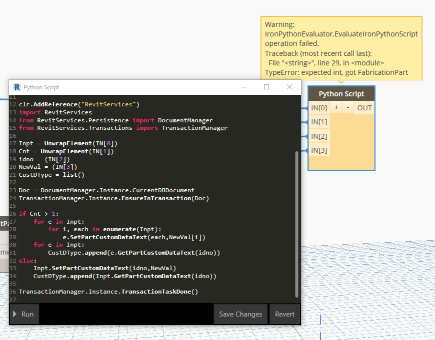

Doing it like that results in an error where the function is expecting a fabrication part element and it is getting a integer.

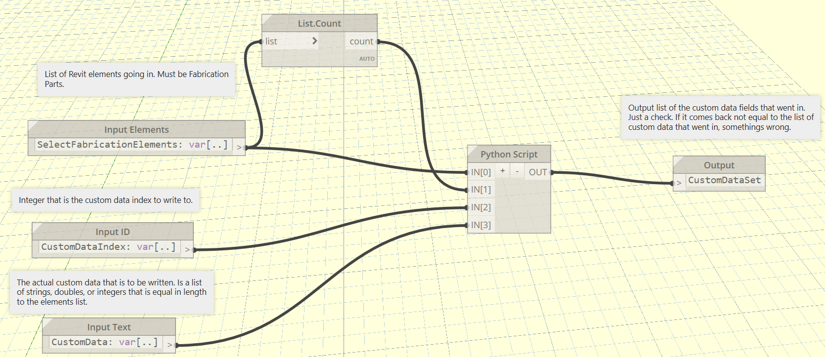

Here is the custom node I built with it. It just takes a list of elements, the index of the custom data, and the custom data you want to write to as an input. I’m not really using this node for anything else yet. I’m still working on the front end part of the tool in building that will eventually use this node.
