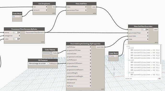

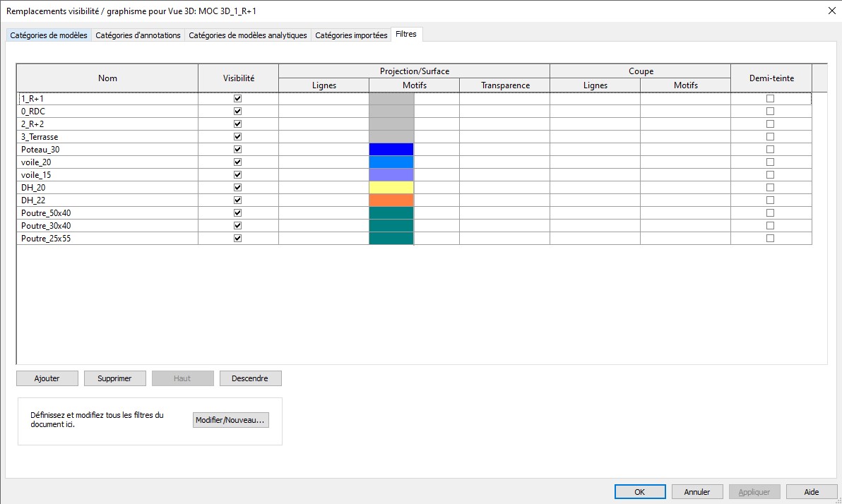

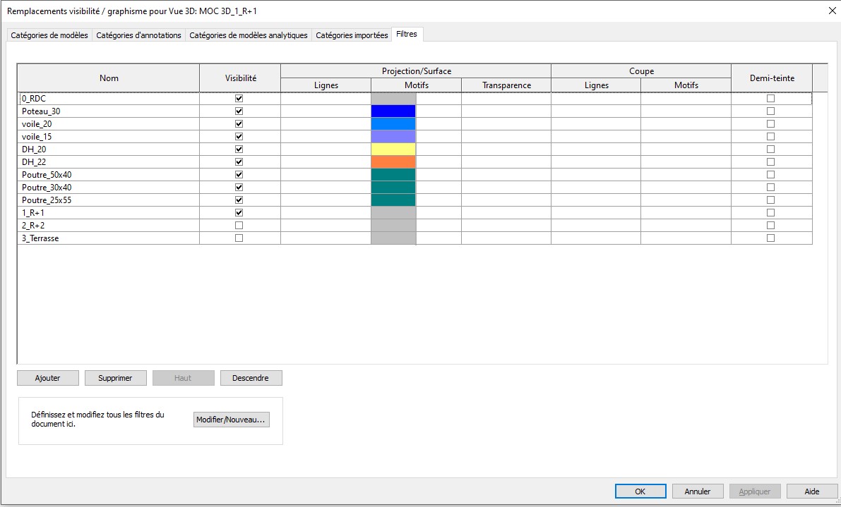

is there a custom node that allows you to move the view filters as you could do manually (while keeping the association of the graphic filters)
or must the view filters be sent with the graphic association desired by view
In the script extract I sent the view filters in 2 distinct phases (by type of categories, and by level)

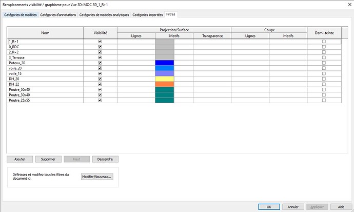

Hello, thank you @ you for unearthing these topics, as I am under a version prior to 2021, I still have to do list rearrangement to send the parameters of filters and graphic properties by parameters to the different views
Thanks to M. Cyril and M. Amolshah on related topics too, and Mr. Marcel (who had already struck that I already had the solution in the original question)
