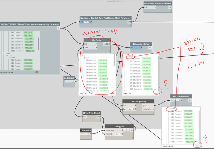

I am trying to get only the unique sublists from a master list. However it is not working. I thought all I had to do was us a unique items node according to this post: Sublist Count
But that is not working for me. Also, neither does her secondary solution. I tired both. in my parent list I have 3 sublists. 2 of which are excactly the same. but not matter what I do or what level I set the nodes to, I can only get either one of the sublist or all 3. What gives? what am I doing wrong? Thanks!
scrolled down master list:

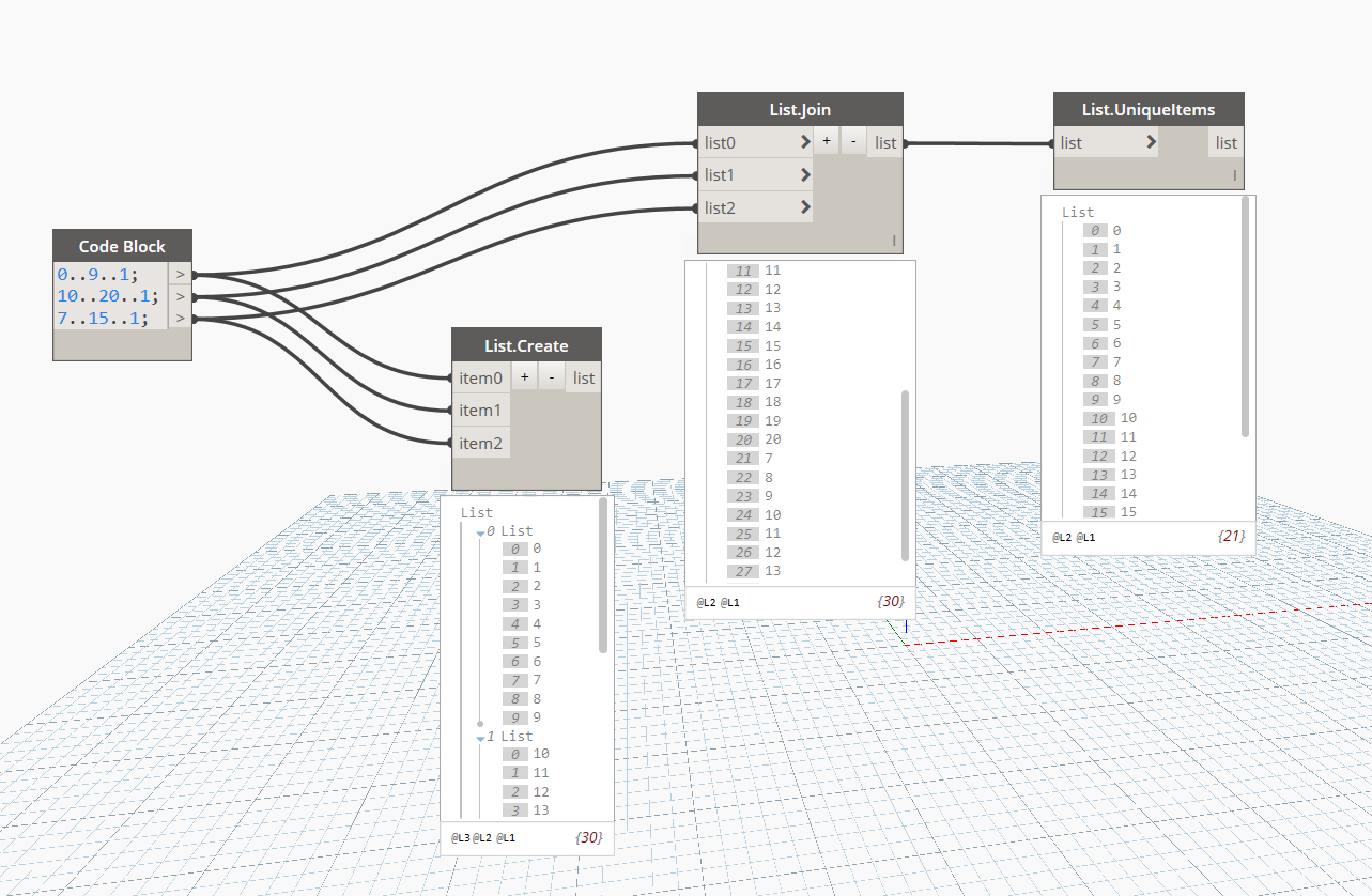

I could be completely wrong but this list manipulation nodes worked for me:

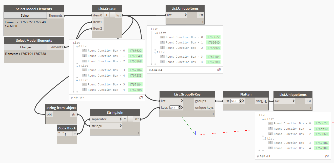

Hope it will help you somehow. :slight_smile:
