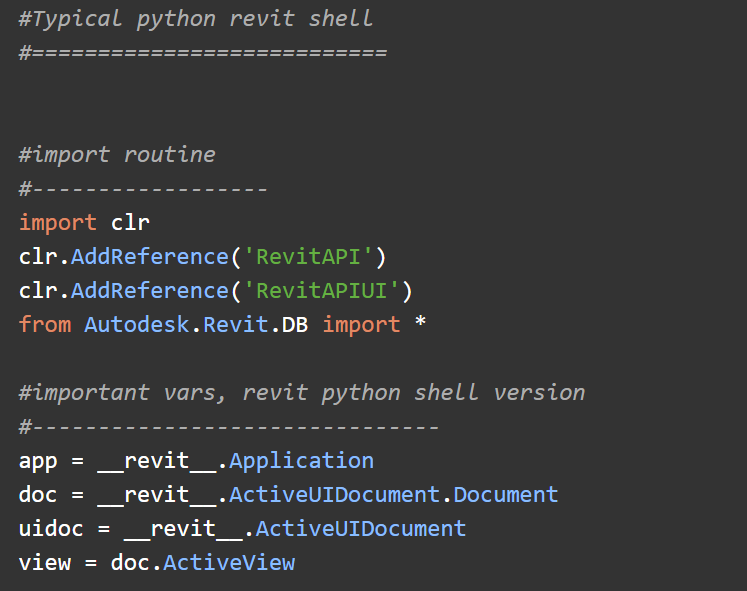

You don’t need to access RevitServices in RPS. Often you will not have to import too many libraries as you will in dynamo. API and APIUI will be enough. Also note the global var _revit and _window. These are not set in the dynamo interface. _revit is your access into various revit globals. Here is the typical RPS imports:
And here is Dynamo:
Hope that helps!
