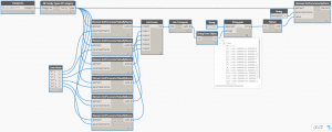

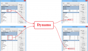

I am trying to create a Dynamo script which can handle below tasks:
- Get value from different fields in a family type
- Concatenate the gotten value with separators
- Write the concatenated value to another field
My idea (as shown below) does not bring me the expected result
Please let me know your idea
Thank you

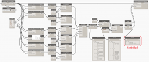

Your second image cannot be enlarged. Can you re-post it, please?

Hi Andreas Dieckmann,
I re-post the second image with some modification
Hope you can see it
Thank you
Hi Peter Kompolschek,
Thank you for your suggestion
I came across the post from the link you provided, but it seemed not to satisfy my case
Please take a look at my second image to know more about my case
Thank you anyway

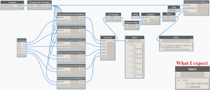

It’s like Peter said - you can do that a lot faster with a code block. Feed the results of your GetParameterValueByName nodes into a code block that has a syntax like this:
var1 + “x” + var2 +“x” + var3;
you can’t did the job at second image because of family 600x800 does not have the parameter [d,bf,tw,tf],
if the family not have the parameter that will become list of nothing “”
like the last result of you image [600x800x{d}x{bf}x{tw}x{tf}]
because other parameter is nothing so that will become [600x800xxxx]
so you need to separate different group of family by parameter
if you do not have a naming convention that is general for your families you will have to check the families first, create two different lists and then create the text parameter
Andreas,
I am afraid your suggestion can not handle well in case the items in the list are empty the as the separators still remain in the returned string
For example, in case var1 is empty, it will return “xvar2xvar3”. But what I expect is “var2xvar3”
Anyway guys, I seemed to find a solution finally, although it does not look like a professional way
Thank you all for your idea and advice
Anyone better idea, please contribute
Look forward to receiving more professional solutions from you
