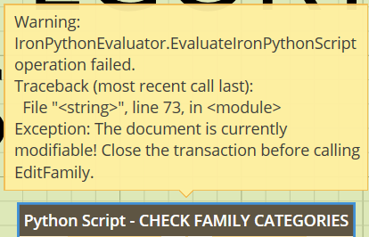

I am having trouble managing transactions and using the family manager. When I run the script, I notice that each time I try to open the family manager it fails (excepts). After I remove the Try loop I get the following error:
1
I am trying to do the following:
  1. Load families into a project if they are not present
  2. Check the family category against the stored Excel value. I want to use the family manager for this even though I can achieve this with some other code.
  3. Create the required family types. An issue arises when all the types of a family in the project has been deleted as there is no type to duplicate. I also want to use the family manager to create a new type.
Is it possible for anyone to look at the way in which I am using the transaction manager and tell me where I am going wrong? Initially I had all the code in one script, but I have now broken it up into separate nodes to try to isolate my mistake. Please find attached the .dyn file. I also append the code for the two nodes.

		#AM I CODING THE TRANSACTIONAL PART CORRECT?
		TransactionManager.Instance.EnsureInTransaction(doc) # INITIATE THE TRANSACTION
		try: # TRY CATCH ERRORS
			famDoc = doc.EditFamily(oFamily)
			if xCategoryNames[i] == famDoc.OwnerFamily.FamilyCategory.Name:
				rFamilyCategories.append("OK")
			else:
				rFamilyCategories.append("ERROR - Family category does not correspond to what is listed in Excel")
		except: # IF THE FAMILY WAS NOT LOADED
			rFamilyCategories.append("ERROR - Family category could not be retreived") # STATE THAT THE FAMILY HAD TO BE LOADED BUT DID NOT EXIST IN THE LIBRARY
		TransactionManager.Instance.TransactionTaskDone() #CONCLUDE THE TRANSACTION

This seems to have sorted the issue:
		#TransactionManager.Instance.EnsureInTransaction(doc) # INITIATE THE TRANSACTION
		TransactionManager.Instance.ForceCloseTransaction()
			else:
		#TransactionManager.Instance.TransactionTaskDone() #CONCLUDE THE TRANSACTION
A couple things here.
  1. In node one you set up t1 as a transaction, but then you never use it. If you want to manually use a transaction like this, which can be good if you need to give the user the ability to “undo” parts of the graph, then you have to Start it, Commit the changes, and then Dispose of the transaction after you have defined it.
t1 = Transaction(doc, ‘This is my new transaction’)
t1.Start()
“here is where you do stuff”
t1.Commit()
t1.Dispose()
“clear your ram”
In your second post, it would probably still be a good idea to do the family editing within a transaction by placing the ForceCloseTransaction() line above the EnsureInTransaction, but as you are finding out Dynamo and Revit do a pretty good job of creating transactions when needed.
Thanks Sean, There are also sub transactions that can be used in the same way.
http://www.revitapidocs.com/2018.1/801e5f17-cab0-044d-835c-a39592374f89.htm
I will certainly use force close transaction from now on as default coding. Thank you for your time. Kind Regards, Paul.
