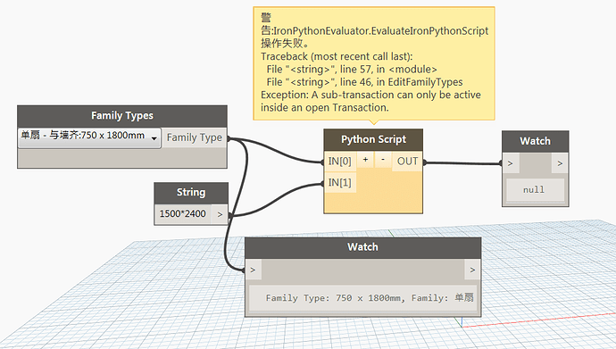

Hi ,
I want to Create many new door Types by given varies door types and specific door names, I know there is a node called “ElementType.Duplicate” in Sprins Package, but i want to use the NewType() method to write my code,to make things simple, I write a test code. Everything runs well until i add the code “familyManager.NewType(doorName)” ,the exception is shown in the pic.
can anyone help me out? any suggestion will be appreciated.

def EditFamilyTypes(document,familySymbolInput,doorName):
TransactionManager.Instance.ForceCloseTransaction()
if None == document or None == familySymbolInput:
return
family = familySymbolInput.Family
familyDoc = document.EditFamily(family)
familyManager = familyDoc.FamilyManager
familyTypes = familyManager.Types
familyTypesItor = familyTypes.ForwardIterator()
familyTypesItor.Reset()
types =
bl =
newTypes =
while familyTypesItor.MoveNext():
familyType = familyTypesItor.Current
types.append(familyType)
for type in types:
if type.Name != doorName:
# bl.append("True")
newTypes.append(familyManager.NewType(doorName))
return newTypes
