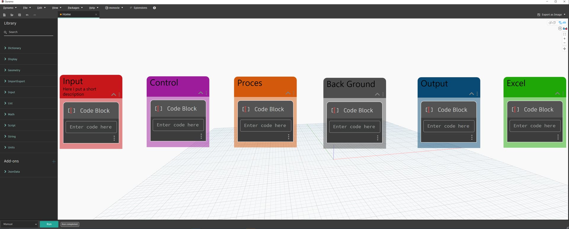

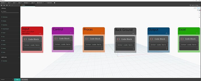

Hola amigos. Once I tried to document my scripts in detail but the truth is that I didn’t make it an habit, what I do a lot is to group nodes and give them a good title and sometimes a description, I guess it counts as documentation.
