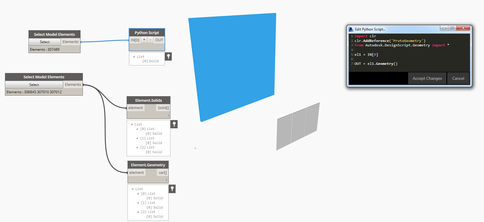

I have 3 panels (all of them are the same Family) and when I tried to get Solids, only two of them works, the central panel returns null
Any idea to fix this error?Hi Sergio,

Hi Kulkul,
I appreciate a lot your help! Element.Solids and Elements.Geometry don’t work for me, but your Python Script put me on the way to solve my issue. The problem is that my Python skills are very poor, and I do a few of “Frankencode” to adapt for me this code (http://pastebin.com/tdrSfjKM), and… It’s alive!!
The last question to solve is that I don’t know what’s the issue with my families with the core nodes (if I make instances of the panel, some of them appear correctly and others return null values, I can’t find a pattern).I will continue the research.
