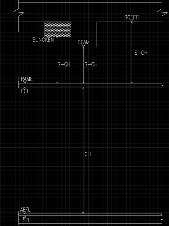

How can I use the dynamo to show the distance between the top of ceiling with the bottom of the upper-floor structure?
BIG Thanks.
Do you want a annotation in a section or only a distance number in dynamo?
I hope to get a numerical value.
In fact, in the process of MEP coordination, I hope to know how much E&M zone can be left for the pipe and line, so I hope to show all the distance between the top of ceiling with the bottom of the upper-floor structure in the RCP(Reflect ceiling plan)
