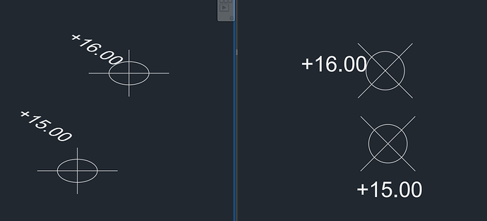

I have a list of points with a correponding Description acording to each 100 meters. Is it possible to rotate 3d text with dynamo in civil 3d or in revit? im a complete newie using dynamo, as you might understand theres like 100 kilometers of points.
This how it looks like right now. i need the text to be vertical to its own axe

Can you share a dwg file with 2-3 points (including the edited ones)?So we can understand better. Just copy-paste some points (not everything) to keep your work as private as possible.
Thats Correct! and I want to rotate only the Z axe (that its not possible with a civil 3D parameter), and use civil 3d to rotate XY axes, just like you might see bottom!
