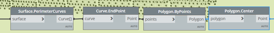

For now I am using rather slow method of getting end points of surface sides, making polygons and then using polygon center node.

As an alternative Topology.Verticies > Vertex.PointGeometry > Point.Average should be faster than the permeter curves method.
