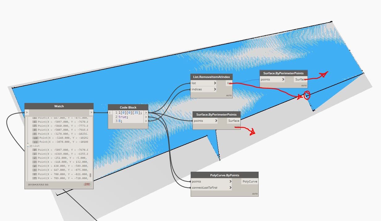

When a point is very close to the perimeter of a surface as here with point 8, the surface becomes bigger than the perimeter. While this point is not intersecting the surface. (grey area)
when I removed that point it is generating a good surface (blue area)
When I scale the surface with a factor 1000 it is going well with both areas.
Is this solvable.
