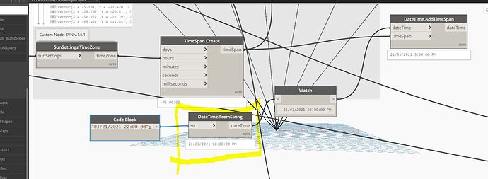

I got the current time zone form one view, then I need to use this value to add to all the StartDateTime valuse of all the views I need to process.
See new screen shot: how do I add the -8 hours of timezone to the “StarDateTime” port of the big Archilab node?

If output is a string ,you could try feeding the “StartDateTime” into the Date.Time.From.String node similar to below

I figured how to add the 7 or 8 hours difference, using TimeSpan.Create and AddTimeSpan nodes…
The Archilab node must be returning Greenwich time, which is okay, except, the hours returned are not consistent across the views. 3 views get one more hour, out of the Archilab Settings node.
I double check my views and I cannot understand why the node returns those hours for those views.
@Giovanni_Succi not familiar with your timezone but maybe daylight savings isn’t being accounted for ?
Yeah, that is the only explanation.
March, June and September fall within DLS, while December doesn’t…
