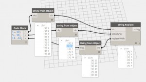

Hi
see the image below
i was trying to Replace 5…10 with 11…15 but the node does not work for multi replacement,
The goal should be {1,2,3,4,11,12,13,14,15,16}
any idea?

For your example this would work, but be careful using strings as numbers to replace as if you attempt to replace the string “5” with “19” for example in strings such as “15” you will get the result “119”.

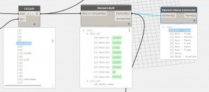

the real question is i have a list of information and some of the number
is the element id and i want to replace it with the name of the element
thanks
