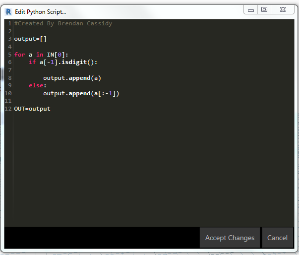

Maybe this python script can help you.
Would something as follows be what you was after?
Code:
#Created By Brendan Cassidy
output=
for a in IN[0]:
if a[-1].isdigit():
  output.append(a)
else:
output.append(a[:-1])
OUT=output
Image of code:
