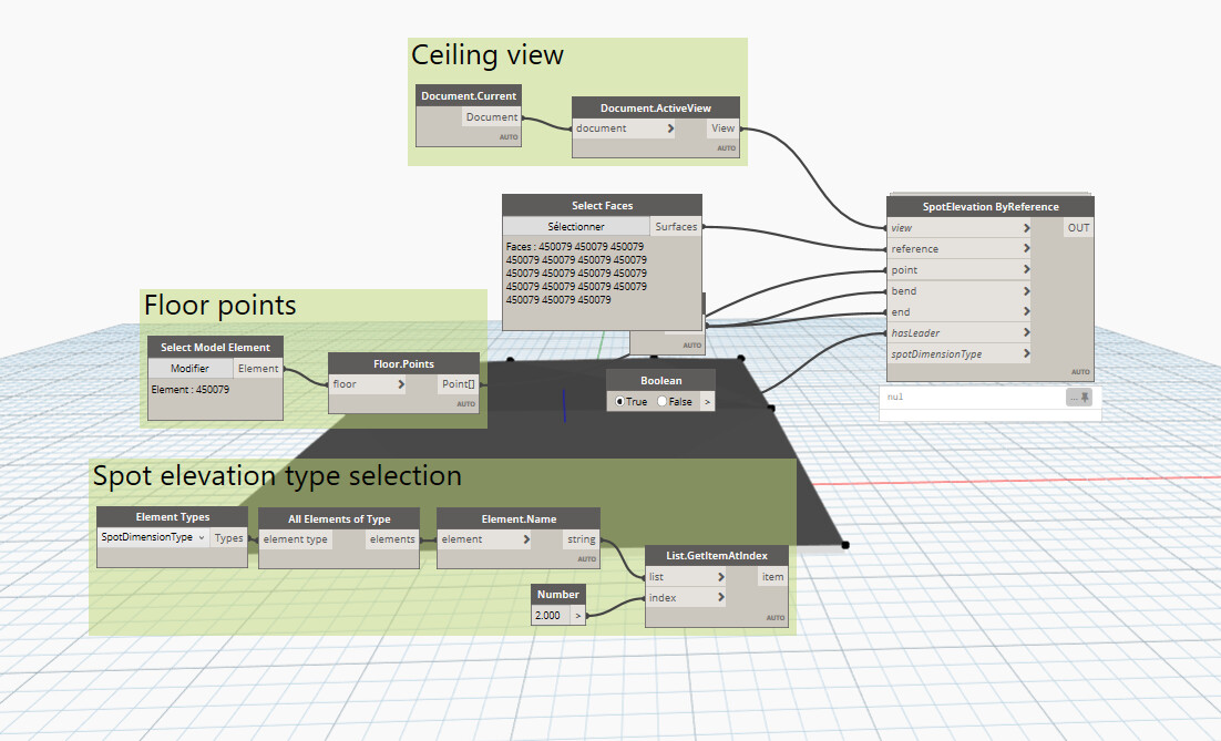

hello everyone, did anyone of you work with the node SpotElevation ByReference in GeniusLoci package, i’m struggeling with the reference, it returns null anyways..
Hi @Eya.bezzine you feed in surface that one expect reference, in genius loci package there is a lot of nodes for reference, guess for surfaces reference as well :wink:
