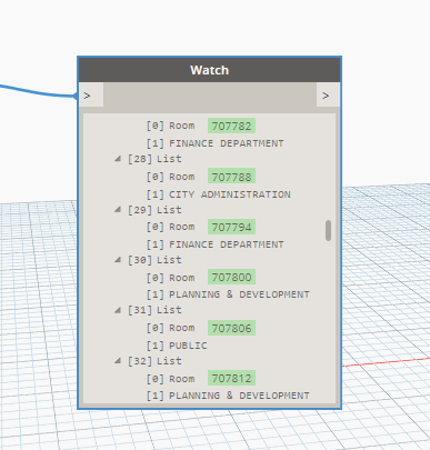

Hello all,
I am trying to sort this list in a very specific way. As you can see, the list is comprised of many sublists. Each sublist contains a single room element and a corresponding Department name. I would like to be able to sort this entire list (of sublists) by those department names for example, so that all “Circulation” rooms would come before “Police Department” rooms. I am essentially trying to match the Sort Order of my room schedules. If my sort order is set to room number, I would love to have a list in dynamo with all of my rooms in the exact same order as the schedule.

Sort Order
Use SortByKey
Thanks guys! Both of your solutions will work excellently. I appreciate it.
