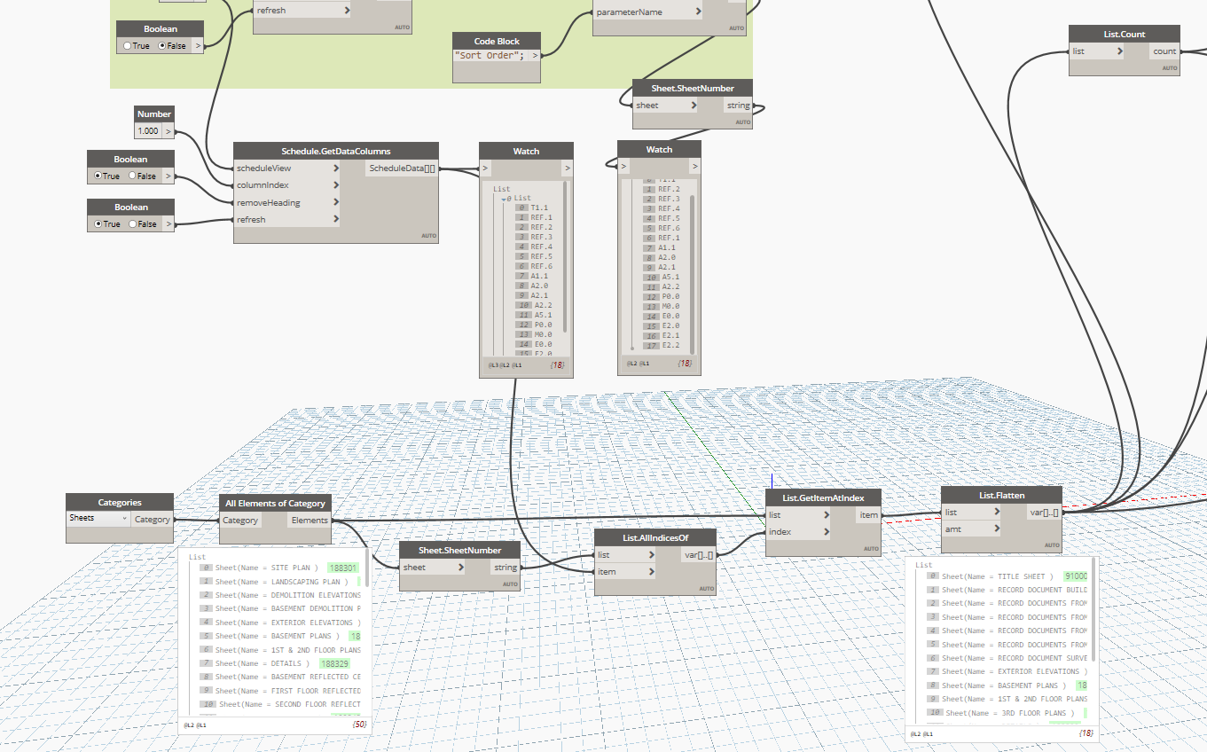

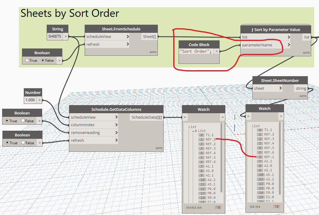

Is it possible to sort sheets by two parameters? (First by “Sort Order” then by “Sheet Number”, keeping the Sort Order in tact as it does in Revit.)
If not, is there a way to use Shedule.GetDataColumns to sort sheets? (This correctly sorts the list, but it only returns a string.)
Thanks for your help!
I answered my own question with the help of this Sort in Dynamo exactly as in Revit
I was able to use Schedule.GetDataColumns node which is great!
