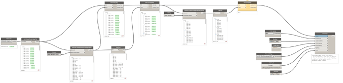

Hi All,
I’m trying to bring in a viewset of sheets so that I can sort them by sheet sequence group for a combined PDF. I’m able to bring in the views and sort them by sheet sequence group, but then they are still organized by element ID instead of by sheet number. I’d like to sort the groups of sheets in the “GroupByKey” node by sheet number, similar to the project browser.
The issue is when I try to sort the list by sheet number after sorting by sheet sequence group, the node returns “null” instead of a sorted list.
