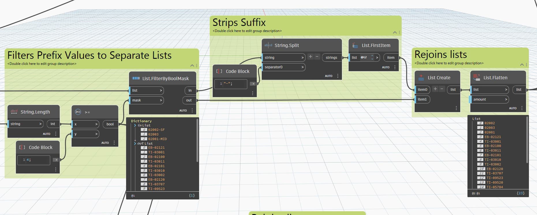

I need help sorting a modified list by the original list. I separated the list, did some suffix and prefix changes, then recombined the list. but I need the final list to be in the same order. any thoughts?

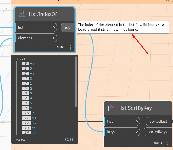

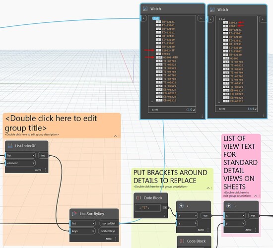

thought it was fixed sorting the list prior to adding brackets using list sort by key. everything is in order except the items that have had the suffix removed.
can i make it not a strict match?

that’s because i had to separate the list to alter the particulate items then combine them

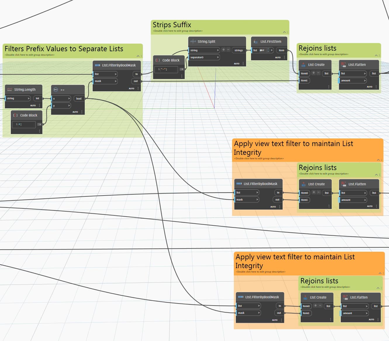

Got it working by skipping the list sort and just using the bool mask + list creation in other parts of the graph. seems jankity, but if it works why fix it.

adding the modified items to the front of the list still give me issues since the items I separated are in the middle (essentially could come from anywhere in the list). the outcome is still an out of order list.

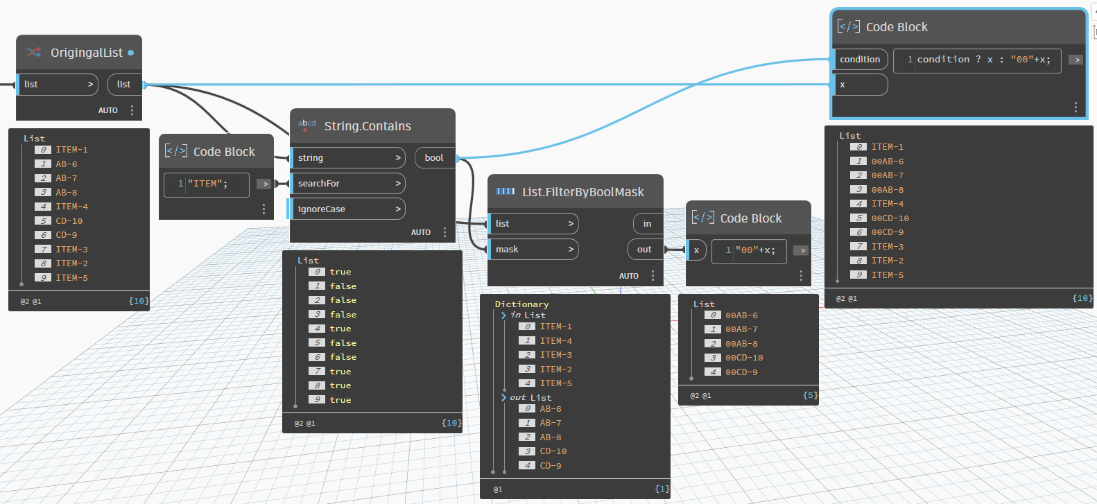

Yer, Code Blocks are pretty powerful. Just Like Node to Code.
Without seeing your INPUT (read; original List) it is hard to come up with a better / more robust solution, but i think my second option (image) would deal with this :point_down:.
You can likely do the whole thing in a Code Block with a conditional statement. You could even include whatever your condition is, but the example below uses the results (boolean list) as an input. This allows you to handle everything “in line” so the results keep their order.
