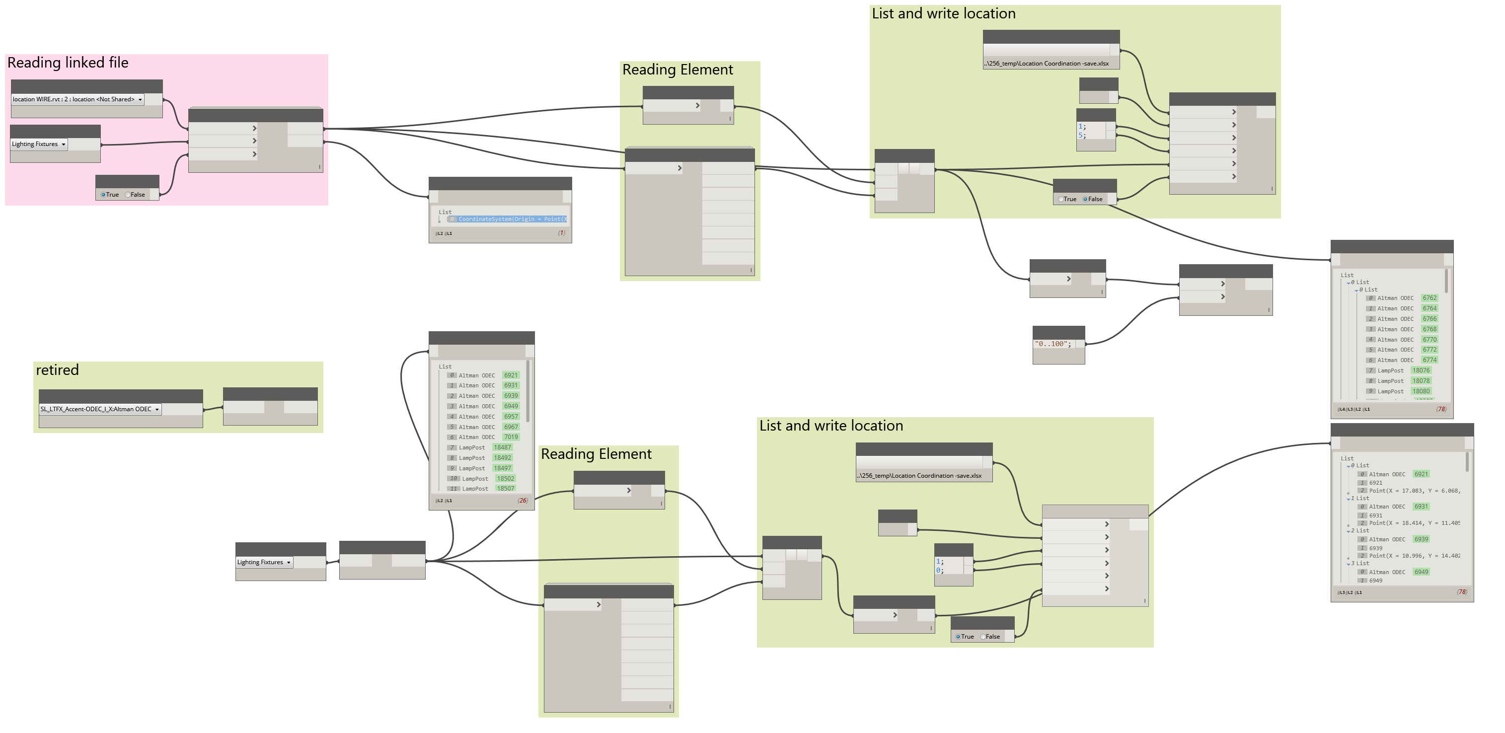

I was reading this chat and wonder if any of you guys can help me with a little problem:
I try to write a script for a " handshake"…meaning I collect instances of a host file and write the name, ID and location to an excel sheet. Simultaneously i want to get all instances from a linked file written in the same Excel sheet.
In the Excel Sheet I just apply a functions to look for duplicate values to identify miss matches. That way I can document the effort.
Well the whole exercise is done to track 2 Consultants work (wire /fixture ) where the wire guy ( Electrical) copies the fixtures from the fixture guy ( lighting) to have an attachment point for his wire… Ideally the original in the host file should have he same location like its copy in the linked file.
Copy/ monitor does not really work for us so we try to use a traceable schedule.
So here is my problem with the script:
The linked file gives me 3 lists of the parameters: name-ID-location ( list 1)
The host file gives me 1 list of combined parameters( name-ID-location) ( list 2)
my question :what node can i use change the order of list 1 to match the order of list 2?
here is the schedule with miss matches

hello mellouze,
I tried that with no success. Here is the larger picture:
When you want to take a picture of an entire graph, zoom in until you can fully read a node and then hit the camera button in the top left, it will maintain the zoom level for the entire graph.
Can you show more of what your two outputs look like, maybe using a smaller data size. We cannot help you fix the structure if we cannot see the structure and the levels of the list.
