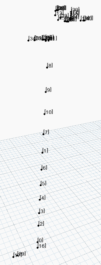

I believe you got my goal wrong.
Objective and create a list with the values ​​contained in the parameter of the families "Pipe section = 129, 1, 159,107,84 … these values ​​are in a list going downstream like the fluid.
checking the image:
the list must contain all elements that have the same parameter for example
list 1 “value of Parameter 107”
[0] Reservoir
[1] Tube
list 2 “value of Parameter 159”
[0] Reduction
[1] Tube
list 3 “value of Parameter 116”
[0] te
[1] Tube
[2] Union
[3] Reduction Knee
[4] Pump
[5] Tube
[6] Union
[n] …
list 4 “value of Parameter 129”
[1] Te
[2] Tube
[n] …
list 5 “value of Parameter 1”
[0] 65mm
[1] Pipe
list 6 “value of Parameter 84”
[0] Pipe
[1] Te
list n "value of Parameter x
@Tiago Yes, I did understand your question.
But somehow Dynamo is not able to get everything in correct order.
If I try to sort the list based on connections, this is what I get:
107
159
129
84
137
1
(you see 1 should have been after 129 but Dynamo is not able to identify that)
And that is something I couldn’t solve
