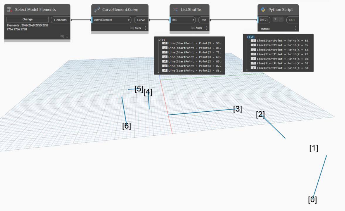

Sort 3D lines so they can be joined eventualluy

Ah - the sort is killing you at a certain point. I’ll try to build another method for you.
If you return the connected polycuve instead of the sorting (see the comments in the code) you’ll get a single chain with that line included even if you make it 1/32" (the smallest dimension reasonable in 3D geometry - 0.0026 feet).
@ning.zhouHNQLJ I updated the python above to deal with minimally long curves (1/32" tested").
