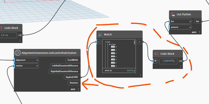

Okay, so the issue is that there are more polylines in the list than section views, so pairing slips somewhere.
Also the polylines were imported to Dynamo in reverse order compared to cant info, so with the list reversed and the 4 closed plines deleted it looks good.
Check the number of polylines and reverse the order.

Amigo @bgalleze buenas. It turns out that everyone gave very good options, it turns out that you were using AppliedCANT instead of Rotation values those values are so little that seems do not rotated blocks but it was, when i changed to Rotation values it works well.
Also when you use All object of Type you take more items that the one you are interest in (more polylines), lucky for you all the polylines that you are interest on are on the same layer, i let you how you can implement this filter.
at the end all this history of rotation could be solved by using Coordintate systems at parameter, and BlockReference.ByCoordinateSystem as Jacob says, conclution allways pay attention what the masters says!!
