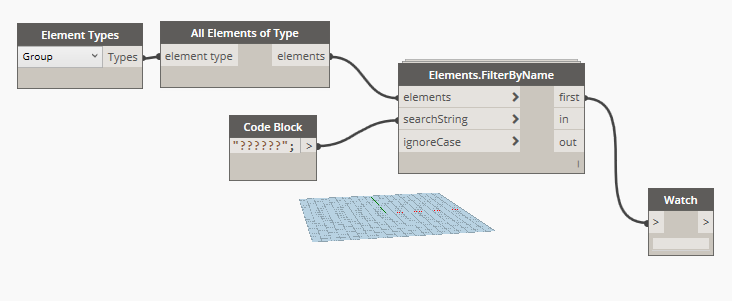

i have many model groups in my project, there are 25 of them that i need, 24 of them have Bed in the name and one of them has Studio, how can i write a code block that it contains both Bed and Studio so i can select all of them? thanks
Capture
Try this:

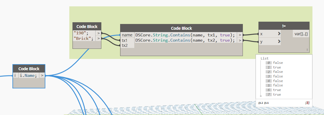

if you don’t want to use a custom node:

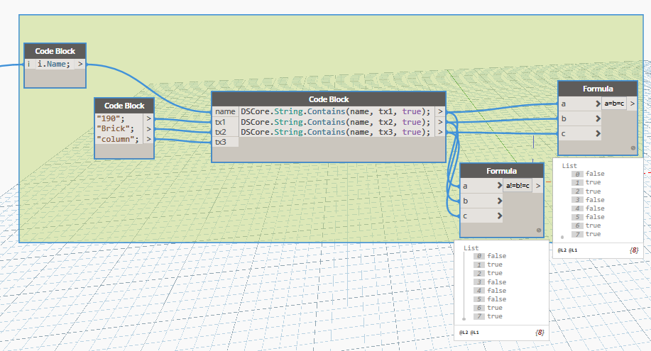

or if you have more that 2 strings to search you could try this (not sure why it works though :grin:)
