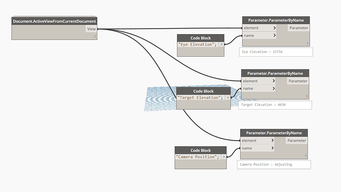

Anyone have a method to get the current camera position? I’m not seeing it in the View’s parameters.
I tried to spot the informations you need and this is what I found:
The camera is looking at “Target Elevation” and “Eye Elevation” but I see an “Adjusting” value on the Camera Position parameter, probably we can’t access this information, but I am not sure about that.
Get the view’s plane as a first step.
