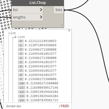

I have this list, It contains a crazy amount of diffrent, numbers. The numbers are the radius of circles. I would like to make a rule, that only allows the list to contain for example 5 different numbers… So something like this…
less than - 00.0010 = 00.0010
More than - 00.0010 = 00.0015
Hoping for the explanation to be okay
And thx in advantage.

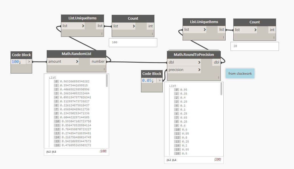

Sounds like you’re trying to round your numbers to a specific precision:

It sounds about right, im having trouble watching the image tho. But think its a problem all around the forum right now? did try with 3 different browsers now
I will get back with a more specific feedback, when i can see what actually happens
i think this is what you try to do.
use "if " after rounding them.

That did the trick, clean and simple thx…
Thx for all suggestions, and they are all useable
