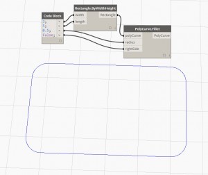

Hi, all :
just get familiar with dynamo for 2 weeks,
see the problem is that i would like to create a round rectangle in dynamo(with a parameter that can adust the fillet)?
But i can not find such function.
Thank you very much for helping.
B
Hi, all :
B
Try out the “PolyCurve.Fillet” node:
HI ,DIMITAR ,THANKS .
