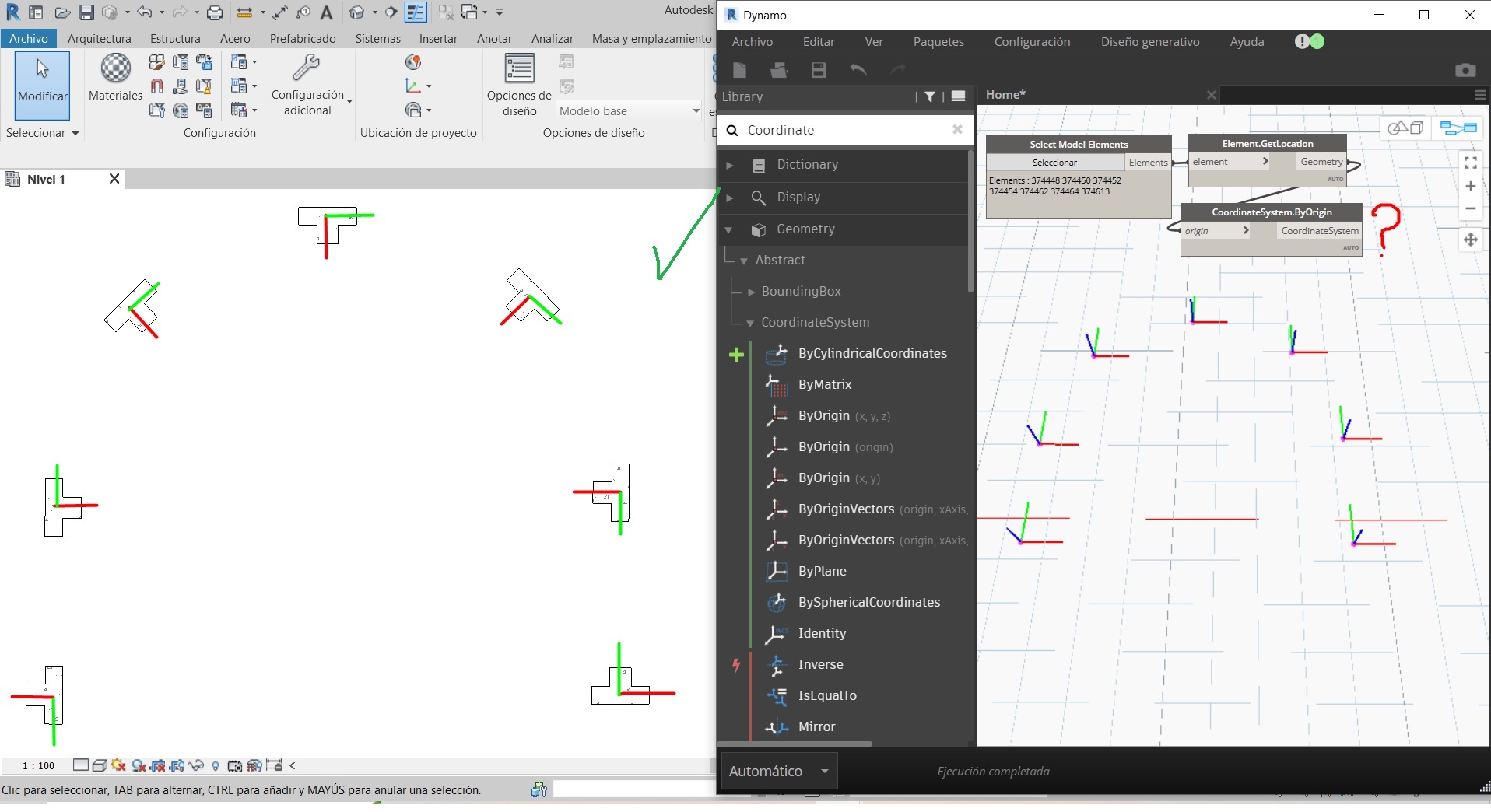

How could I rotate my Coordinate Systems of my columns.
If someone could help me using the native nodes of DYNAMO I would appreciate it since I try to understand the basic logic of how Systema Coordinates work…

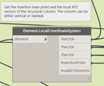

Maybe try this node
(BIM4Struc.Productivity Package)

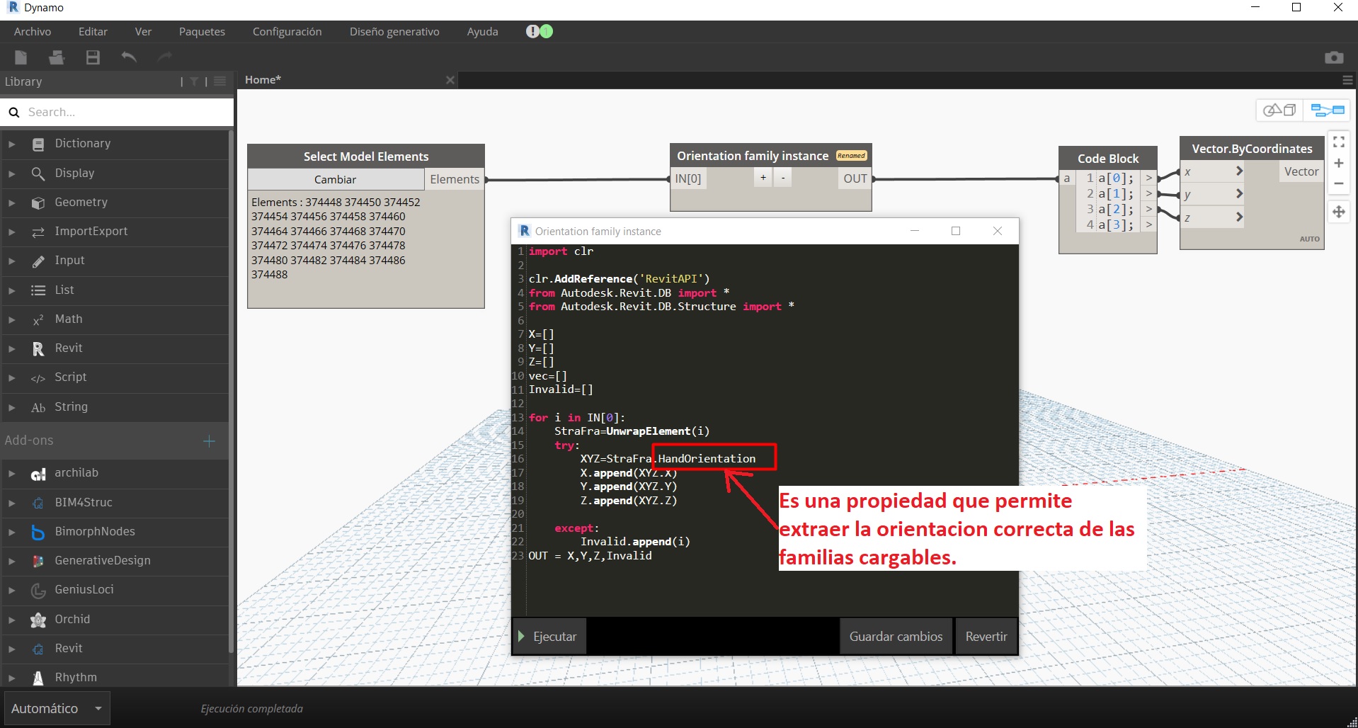

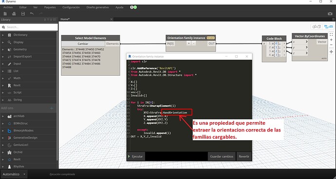

Having managed to solve my problem, I share with you the final result… for those who have the same problem as me…
