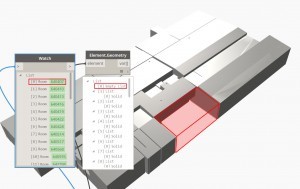

I’m using a “categories” node connected to an “all elements of category” node to grab all rooms.
When I use an “element.geometry” node to generate geometry of each room I’m missing one room.

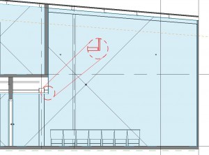

I’ve tried manipulating the list of rooms by reversing it and isolating the problem room. This one room seems unable to be generated as geometry. I’ve compared its parameters to other rooms as well – nothing unusual.
Any ideas for how to further troubleshoot this room? What all can cause “element.geometry” to be unable to generate the geometry of a room?
