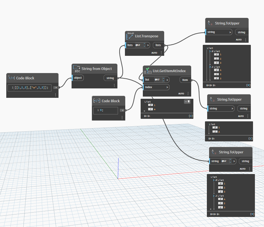

Maybe something like this?
Thanks for sharing! I am new to Dynamo so please excuse if I am missing some simple logic here.
Is the Dynamo sequence you shared an addition to my dynamo sequence or replacement? What confuses me is that it looks as though the relationship to the Room Numbers is missing along with the “Set Parameter” functions.
Let me know, and thanks for your help!
It is an example.

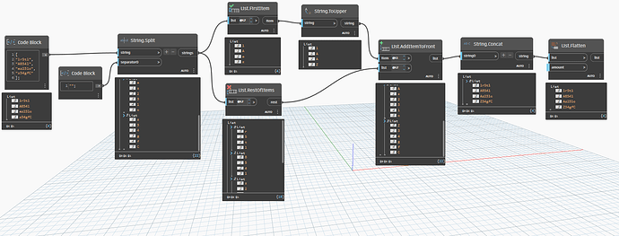

This is more what your after i think.
The first Node (the Code Block) would be your list of Room Numbers.

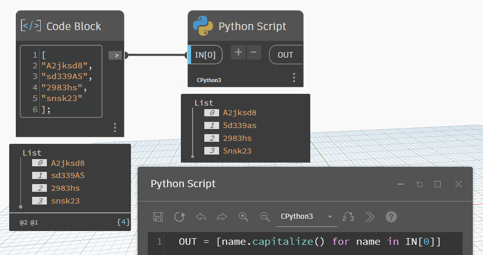

If you haven’t started learning Python yet, string manipulation is a great place to start. There are a lot of straightforward methods that are easy to learn. With a little list comprehension, you can get exactly what you need with a single line of code.
Hi Nick,
Thanks for your post, your suggestion led down the right path! I ended up using ChatGPT (I know) to develop the python code. I have attached an image of the solution I was able to get.
Thanks for your help!
