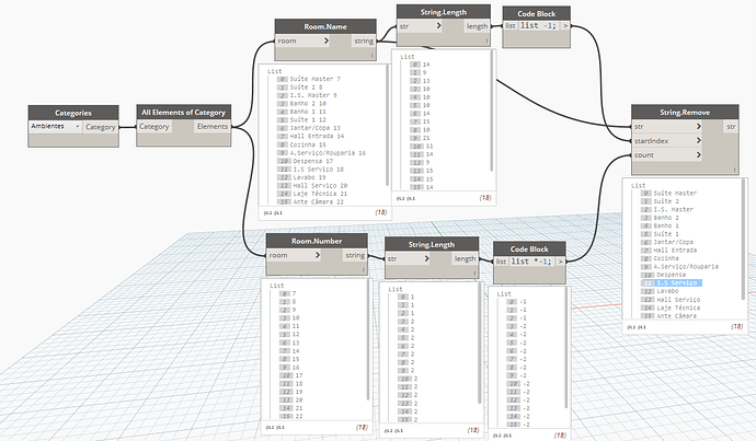

The node Room.Name is returning actually the NAME + NUMBER of the rooms.
In image below, is possible to see Suíte Master 7, but the name of the room is only Suíte Master.
So, i used some nodes to clean this, but, is there any another way to fix this?

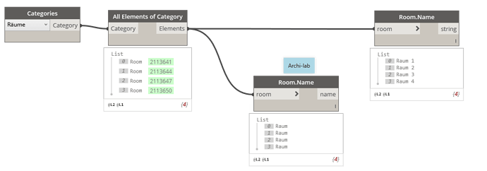

Just use Element.GetParameterByName.
The node from Archi-lab is better:
Is this one?

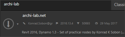

If yes, i installed two times, and both i had problem, and the dynamo “told me” to uninstall.
