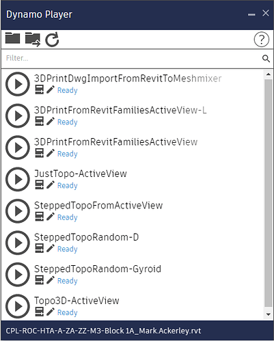

You might be aware… but if you use player it will show all the graphs in a folder in a nice friendly manner…

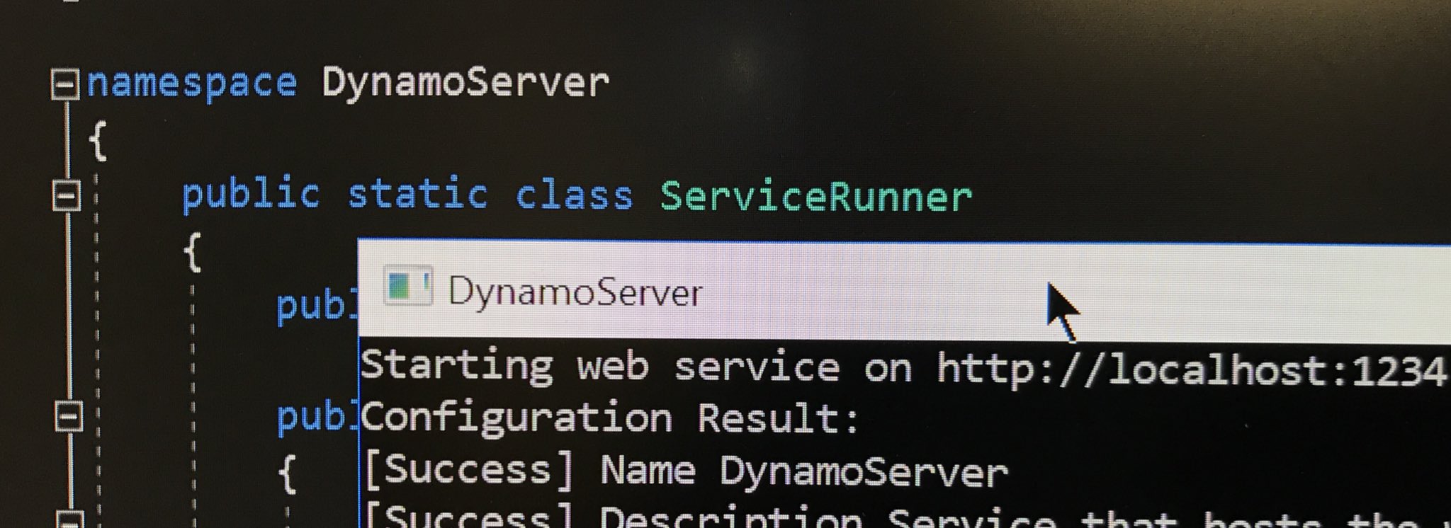

For the rest, this twitter was posted last Friday, very intriguing :slight_smile: @Radu_Gidei
Dynamo capabilities are going exponential…

Thanks for the link Mark, well spotted. Look out for more sneak peeks over the next few days and a launch soon :rocket:
