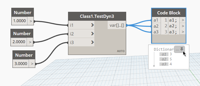

Hmmm, it decision looks me better than return one string:
and result in Dynamo
But I want know exactly how create single output’s parameters
I know this is an old post - but I think you are asking how to write a c# based zero touch node that has multiple output ports:
DynamoSamples/BasicExample.cs at master · DynamoDS/DynamoSamples (github.com)
