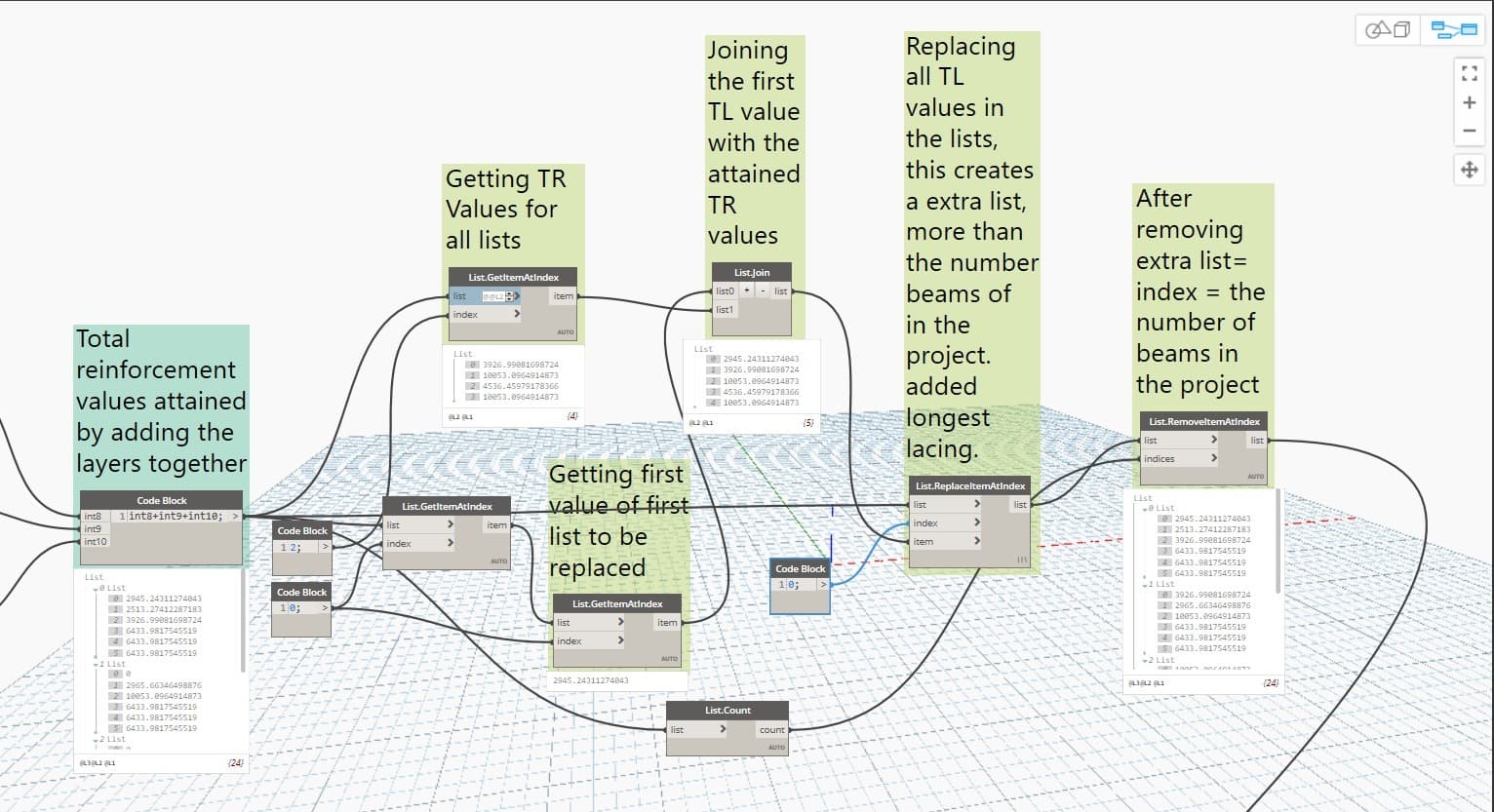

Thanks to Andreas’s help, I was able to come up with the following list. The output of the code only shows the first 2 list, I want to continue this is a loop manner as I have many other sub list. Basically, I want to change the value of list 1 index 0 with the value from list 0 index 2, value of list 2 index 0 from with the value from list 1 index 2 so on an so forth in a looped manner if possible such that it outputs all the lists with the replaced values. Any help will be appreciated.
Thanks!!
Kathir
Hello! I managed to solve the issue by using the OOTB nodes in Dynamo Itself. Thank you Andreas for helping me!
