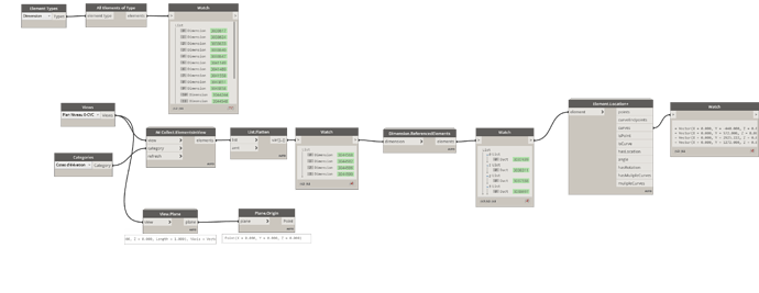

Replace a spot elevation with a label
I’m looking to replace a spotlight with a label

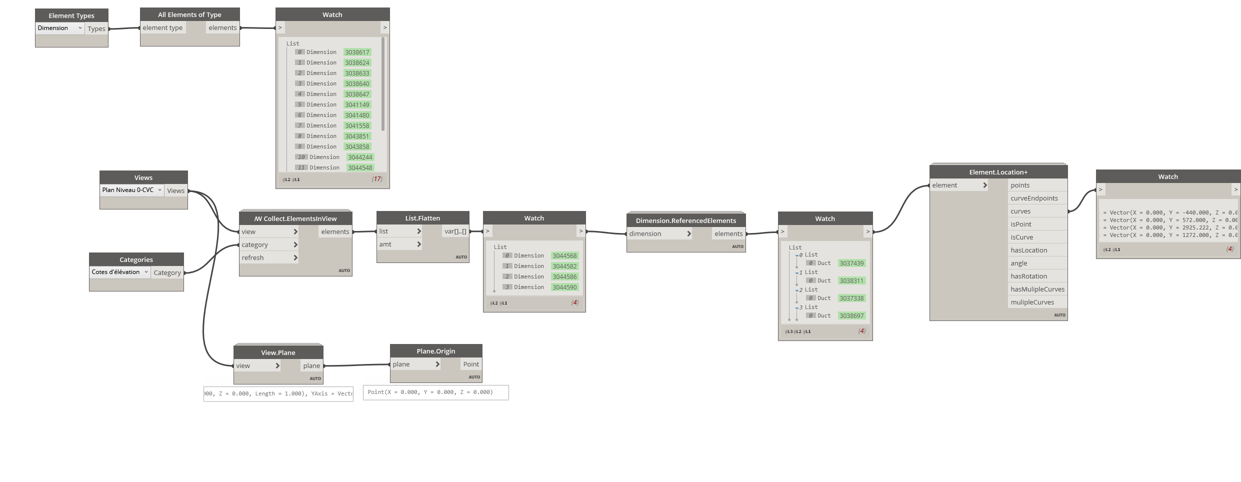

I can select the spot elevation and host, but can’t find the spot elevation coordinates to place a label in the same location.
*** French
Bonjour,
Je cherche à remplacer une cote d’élévation par une étiquette
J’arrive à sélectionner les cotes d’élévation et l’hôte, mais pas à trouver les coordonnées de la cote d’élévation pour placer une étiquette au même endroit.
Capture2
Change_Etiquette.dyn (22.8 KB)

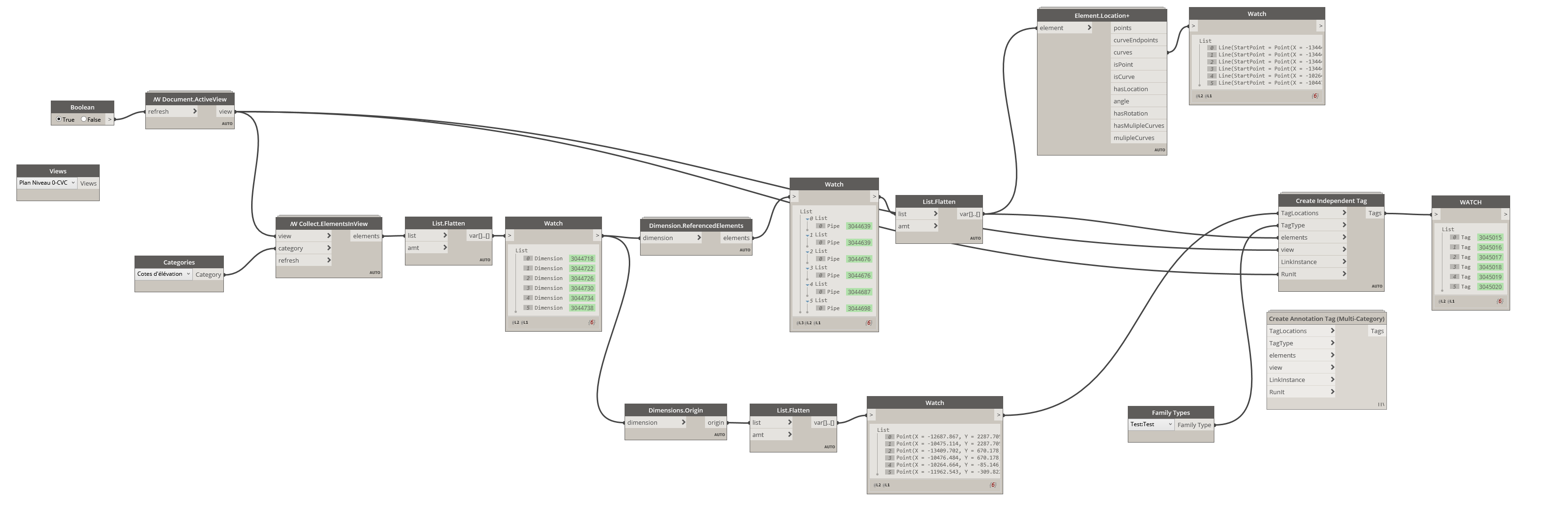

Hello…probably something could help…
Thank you for your reply.
the Tag node is not working (is not a tag), but I searched and found Dimensions.Origin.
Thanks for the lead :slight_smile:

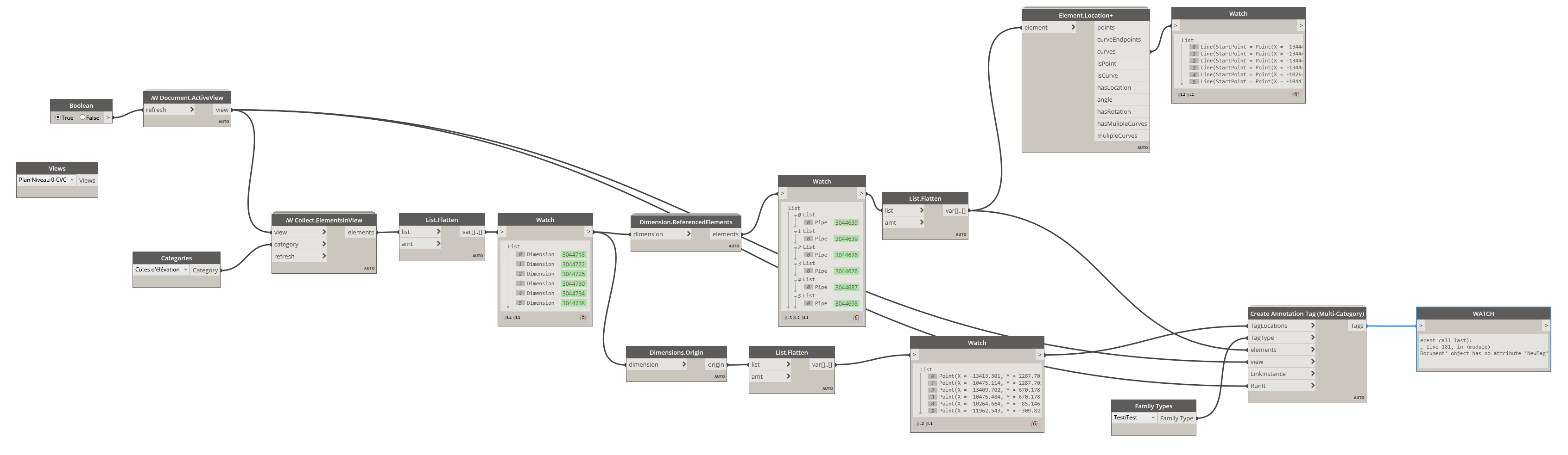

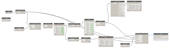

Now I have an error with the Create Annotation Tag node
→ AttributeError : ‘Document’ object has no attribute ‘NewTag’
I have found the answer for the error.

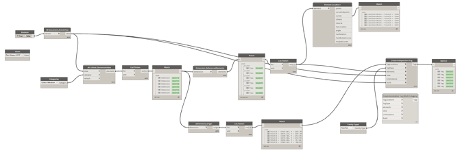

You’re probably working with Revit 2019 and you need to use the Create Independent Tag node.
The Create Annotation Tag (Multi-Category) node is for Revit 2017 and previous versions.

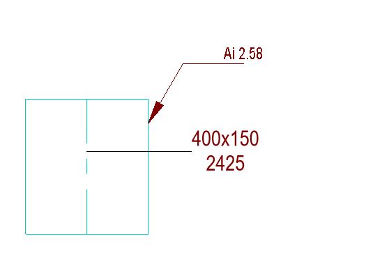

I still have to control the position of the tag.

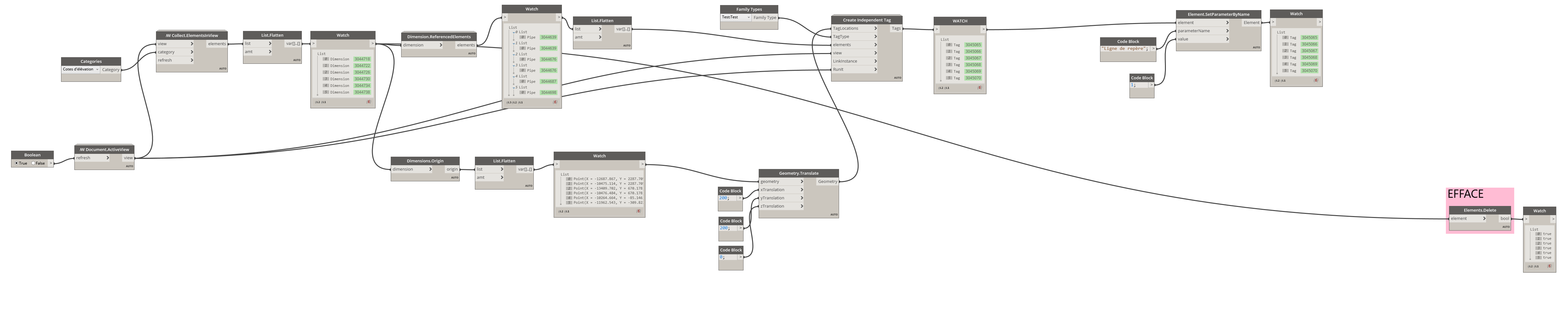

her on driving, and i would like to shift her
Script Completed

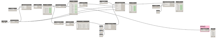

Hi @alain.hamel maybe add the passthrought node before the delete elms node.
Cheers
Ok, thanks for the information, I don’t know the node :+1:
