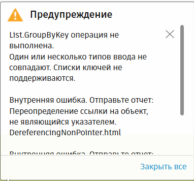

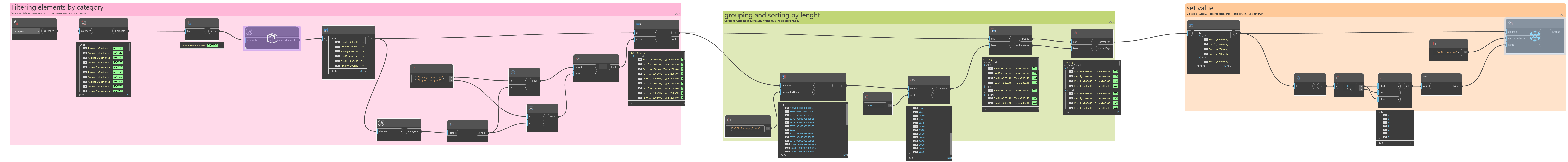

Hello! Im trying to renumber elemets in multiple assemblies by lenght parameter. In screenshot below i renumber columns and beams based on their lenght, but when im trying to do it with multiple assemblies GroupByKey and SortByKey send an error
I`m trying to achieve something like

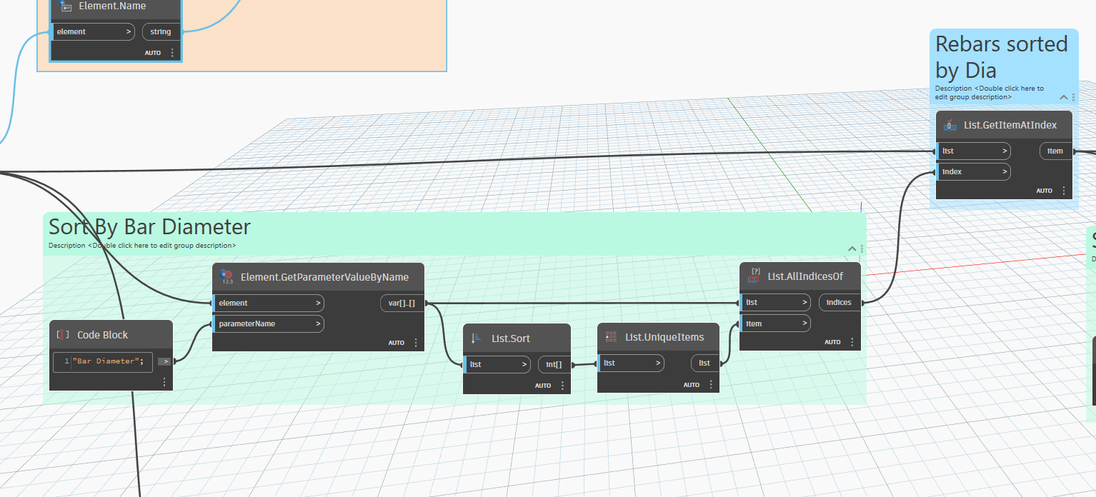

Im pretty sure i did something similar to you. in my screenshot i sorted rebar by diameter in my assembly.
List.uniqueitems would get all the unique or different lengths in your assemblies and List.allindicesoff will sort thorugh the whole list.
if you copy this it will give the same value to the elements with the same lengths. so beware of that

what does the error say?
and could you pin the outputs in the grouping and sorting by lengths group, so we can see what happens
thats for 1 assembly
thats fro multiple
In our company were using russian language in interface, so i cant provide you text in english

now its showing other error

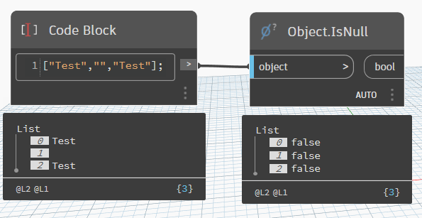

Visually check the list to verify. The Object.IsNull will show false positive results for certain things.
