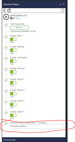

Should work fine in player. Just change the name of the âboolâ nodes to, âInclude XREF?â and right click them and click âis inputâ. Do the same to the âCADâ folder path node.
If you want them to exclusively use the player and they need to add xrefs that arenât listed in your bool toggles. They can add the name of the xrefs to a string node like this.
XrefUpdates-V3.dyn (80.5 KB)

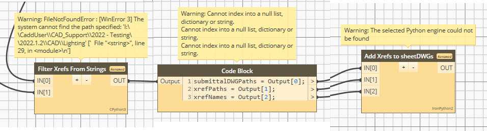

Also, see image for errors.

It will attach the xrefs that have the bool flipped to true and any additional ones that contain the strings passed with commas between them into the dynamo player, into all DWGs in the the âDrawing Setsâ folder and any subfolders within it.
1.) I added another input which allows you to exclude the attachment to drawings in the âDrawing Setsâ folder by string. So if you donât want to attach the xrefs to a file named âGeneral Notes.dwgâ you can just add âNotesâ as one of the strings in the dynamo player.
Now someone can use the two string inputs to add any xrefs that arenât listed in the bool toggles or to filter out submittalDWGs from getting attached to.
2.) You are getting an error because the file directory you provided me had a âlightingâ folder but the code couldnât find a âlightingâ folder in your directory. I added a try, except statement to handle this.
3.) You do not have ironpython2 installed. ironpython2 does not come built in anymore and has to be installed. You need ironpython2 to attach xrefs because of @jacob.small 's previous comment:
The reason for the issue is that CPython canât generate classes in the same way as IronPython because in itâs case the call from inside the house. Basically youâre already in .net, so creating a class wonât work without creating an instance, and you canât create an instance without the class⌠It gets somewhat messy in Revit but from what I am seeing itâs VERY messy in AutoCAD. The CPython feedback thread has more technical info if youâre interested.

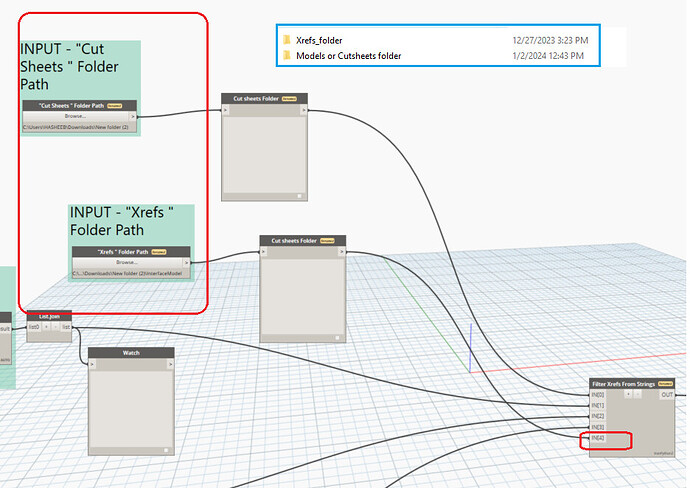

Your dynamo script working on model or cutsheet file in same folder of xrefs.
I tried to fix this dynamo to be able to read multiple cutsheets in separate folder and to import or reload path for xrefs from another folder but it didnât work.
Appreciate if you can double check
XREF Base Files To Sheet dwgs.dyn (70.8 KB)
