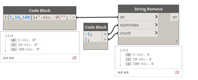

@Simon_Fiele1 If the quotes are always the last character, you could try this…

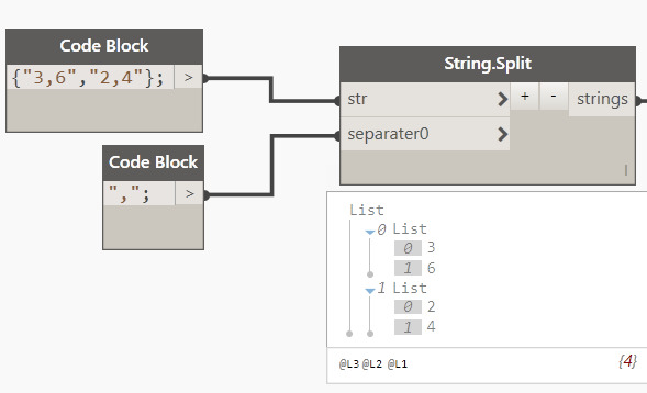

@Lazy_BIM It does exactly the same. String.Split Removes ("). See below for some couple of options using OOTB node and python. @Simon_Fiele1 @erfajo
Using OOTB nodes.
Using Python
