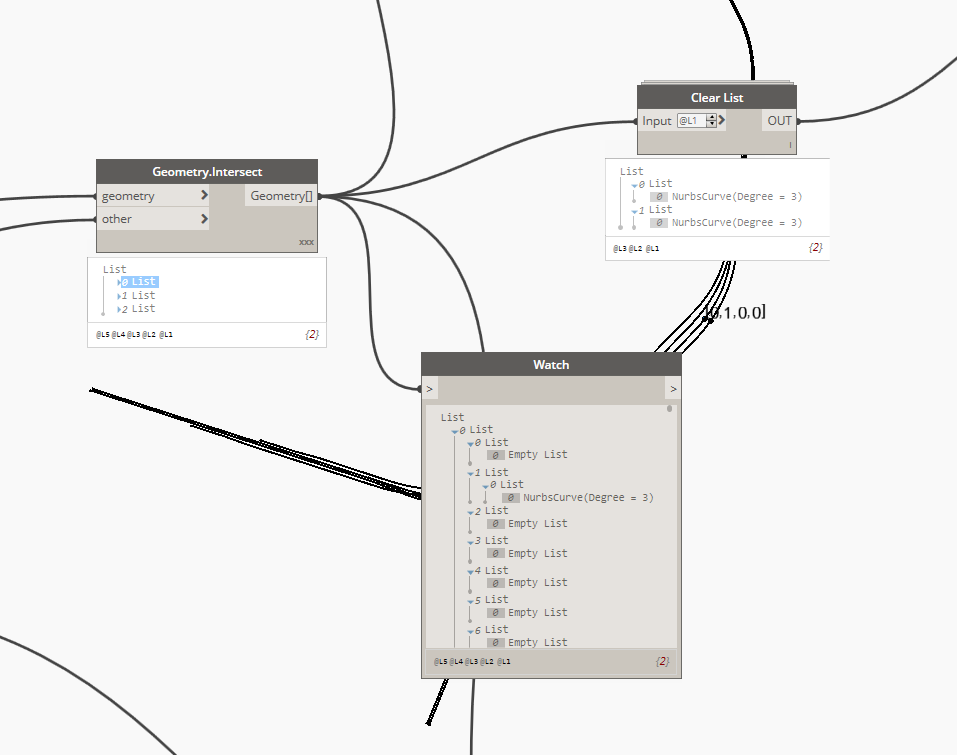

Hi guys I wanna remove the empty lists but want to have my hierachy in the list of list. So basically in this context I want a output list like
  1. Nurbscurve
  2. Nurbscurve
  3. Emptylist
Hope I make myself clear. Help me out. :slight_smile:

Hi Yna, I do understand how levels work. And I have been playing with the levels and Preserving Hierarchy for a few hours already. The issue is with Empty Lists. When I ask any of these nodes to remove the empty lists… they just remove it through n through.
try it out. You will understand what I mean. Have been using Lists and Levels in Lists for quite sometime now.

The issue is I won’t have a nurbscurve in every list of lists. Sometimes its all Empty list (when there is no Geometry Intersect in my case).So dynamo entirely remove the Entire Index without a nurbscurve. I want to maintain the index and list it as null or a single empty list when it doesnt find a nurbscurve. Hope that makes it clear. Check the image.
DanEdu.List.Replace should respond to what you describe:
If not, please send a screenshot showing your initial and expected lists :slight_smile:

Yes this was what I was doing yesterday as a workaround. But @Vikram_Subbaiah’s Method works like a charm :smiley:
